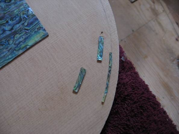

I'm slowly starting the planification of no.3. The top and back are joined. They are not down to thickness, but the sides are.
This will be a first for me. I've never worked with shell. I also want to try inlaying my headstock with a custom logo. (wish me luck!) Another first in the project is a florentine cutaway. I know, as Hesh once told me, I'm a glutton for punishment!

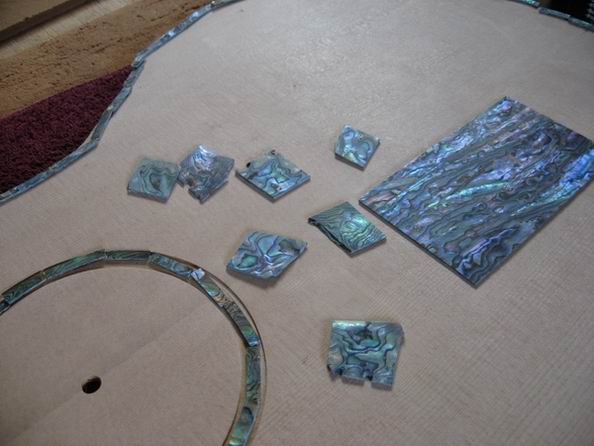

Now these quasi-blanks are a bit wide for my taste. I don't mind a wider rosette, but the side purfling has to be narrow...
I took a jewelers saw and cut one piece in half. I'm slowly 'jigging' up to sand and shape shell to profile.
Anyways, I can see why they say that inlaying shell can double the time for building a guitar!!! I won't say how long it took me just to shape that 2" length! (last pic)

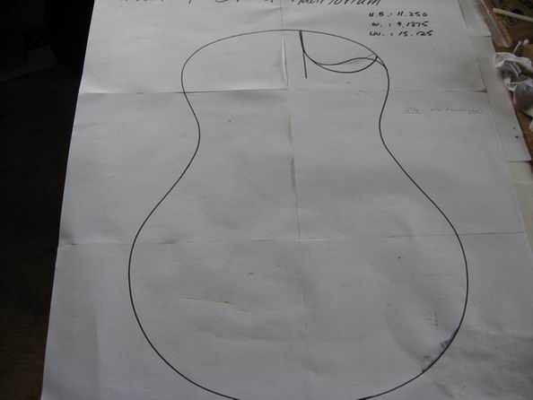

So here's the shape. Smaller than a dread. Grand auditoriumish???

Wohw!! Alain, even using real shell I never radius large pieces of shell for purfling. I use nippers and a file and cut or break as it were short lengths and file edges to fit to make up purfling. In my opinion long pieces with few joints actually make the eye notice the joints more than short pieces many many joints. Not to mention the fact that if you use Ablam or real shell you can buy the stuff pre radiused to 4.93 ID. I applaud the effort but like others have said I am not sure the expense and work yields a benefit worth the time and money in the long run.
I agree with you by the way on the width of purfling. If you use a black/white/black bourder purfling on both sides of 1/16" wide abalone, the black aginst the abalone make it apear wider to the eye and also hides the fack that the joints are not radiused.
Careful breaking of 1/16" wide or even 1/8" wide purfling shell into the channel takes about 40-60 breaks on mid size guitars and can be done with very tight fits in less than an hour or two at the most. and like I said especially with abalone the pattern changes in the shell makes the joints near in visible to the eye because of the camouflage effect.MichaelP38986.3510416667

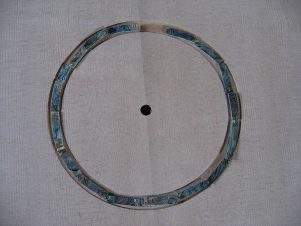

I hadn't really thought about seriously going ahead with the shell inlay until yesterday when I laid it out on the guitar to see what I thought. At first it was just going to be the rosette and then I decided to try the purfling as well.
I'm sure there are many easier ways to go about doing it. I will try the nip and file method for sure. This is shell material I got off of e-bay for very cheap. And being a miser (read poor) it suits my purpose perfectly! I also have that abalam sheet I got from LMI. I think that's going to be my logo material...

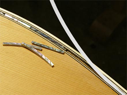

You can install teflon filler strips between the purfling
to take the place of the shell when gluing. I believe you can use most any of the traditional glues used for binding/ purfling,(Chime in here guys).
After the glue is set, you peel the teflon out, leaving a nice clean channel for your shell.
I typically level it,(the purfling), close to the top prior to pulling the teflon, for ease of installing the shell,especially if you're breaking the shell in the channel as you go.

They way I do it, is I put it in the channel, CA the purfling in and when dry I scrape off the extra glue (just enough to get to the channel). Then I peel out the teflon and put in the abalone, with abalam you only need the pieces to be wide enough to fit in the channel, I find the curved pieces easier. You can crack it in the channel and because of the pattern you will never see it when you get it all glued in.

Think of it this way. If abalone was bendable. How would you install it? Just like a piece of herringbone. Now replace the herringbone with the teflon strip, glue up as normal. When the glue is dry scrape off excess glue and pull out the teflon strips. Take your abalone strips and place in the channel left by the teflon strips. The teflon is only there to take up the space the abalone will occupy during the binding and fine line purfling glue up.

Thanks for the good explanation Michael and the picture too.

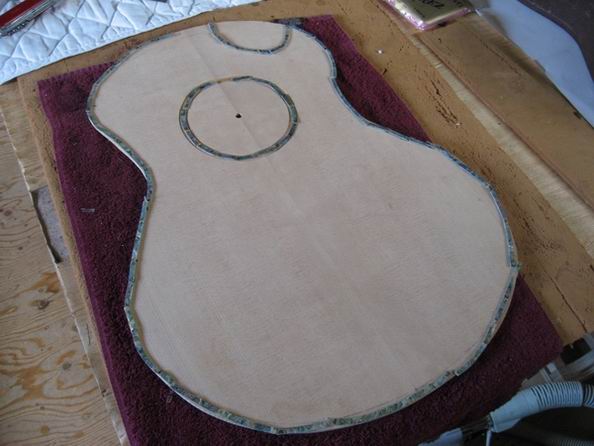

Again, though, the crux of the matter, for me, is that I already have the shell material on hand. I want to use it. I simply can't afford to buy a complete top set of paua shell. By the time the duties and the exchange are done with me that will cost me over 200$.
I'll have to take those large pieces, cut them in half and at the very worst, sand them straight at a 1/16 width.
I do have a carrier board with pivot that I've installed on my press drill (and my 4" radius sanding disc). My next step is to make a little jig to hold the piece of shell as it pivots to the sanding disc.
I want to try and make the 'pivot' movable so that I can easily change the radius I'm sanding. Of course, the shell holding jig will have to be expandable/retractable as well.
I'm thinking that if I can rapidly machine and shape the shell to profile, it won't be so bad. After 130-140 hours, what's a few more?
